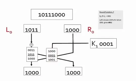

enter image description hereI'm learning about Feistel Ciphers at the moment, but having issues with the formulae, so I can't move on from it.
Encryption:
  1. $_{+1} = _$
  2. $_{+1} = _ \oplus ( _ , _)$
For the round function $( _ , _)$, could someone advise on what exactly I need to do? Let's say my key is $1197$, what needs to happen in between the brackets, $(_ , _)$ , full diagram screenshot attached, thanks.enter image description here

  • Thanks for getting back to me. So If I have a plaintext and divide it into 2 parts, left and right, I need to put the right side through the round function. This should get me my value to XOR with the left side, but i'm not sure what exactly I have to do with the right side and round function in the 1st place. – terodee Mar 02 '19 at 19:54
  • Yes, this is what the 1. and 2. equations already says. What is the problem? Did you see this question? – kelalaka Mar 02 '19 at 19:57
  • Yes I checked he link you supplied but I can't really make sense of it. As I said Im only learning about it now, so still a bit raw with how it works. I did find something on a video from another site, it seems to imply that I must XOR the right side with Key. From here I would shift this value by 1 it and XOR it with the left side, does that sound correct? I have added a screenshot of this above. – terodee Mar 02 '19 at 21:22
    It is necessary to distinguish between on one hand Feistel cipher that is a structure or a tool that is used to construct block ciphers, on the other hand concrete applications of this tool. So $F$ is a function that takes two inputs, it could be any function but requirements are that it provides confusion and diffusion. The output of $F$ is then xored with the other part of the input. It might be worth mentioning that the keys $K_i$ are generated by some other procedures form input key.Now if you want to see a concrete implementation of $F$ then look at $DES$ for example. – Marc Ilunga Mar 02 '19 at 22:02
  • You are using too simplified $F$ function. That is already insecure. – kelalaka Mar 02 '19 at 22:05
I guess it makes more sense if you write the two equations like this (referring to the nice diagram in Wikipedia): $$L_{i+1}=R_i,\; R_{i+1}=L_i\oplus F_{K_i}(R_i).$$ In each round, the round function $F$ takes as input the corresponding round key $K_i$ and the previous round's right output, then computes the output value, which is then XORed with the previous round's left output. $F$ is usually modeled as a pseudorandom function and has many instantiations (see here for a list of Feistel ciphers, of which each specifies its own $F$ instantiation and key schedule). This post discusses the requirements/goals for good $F$ instantiations.
