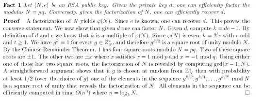

The answer of @robert-mason is good but rather large.
Here is the algorithm and the proof just after.
Source of the proof here (at the end of part 1).
kingsjester
  • 161
    From which paper did you take that screenshot? (I'm asking, because we tend to cite the source for copyright reasons.) – e-sushi Sep 08 '17 at 11:42
    I made the content of the first picture and test it on an example, the source of the second picture is at the end of my answer. – kingsjester Sep 08 '17 at 15:20
