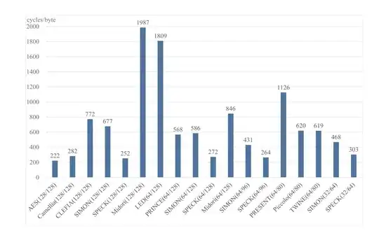

In term of performance, figure 1 shows the speed of ciphers with 1024-byte ROM and 128-byte RAM, I see that piccolo lower number of cycles/block compared to CLEFIA in addition , this reference shows that Piccolo-128 with Encryption has GE area of 1776 produces throughput of 193.9 Kbps (@100kHz) compared to CLEFIA-128 has GE area of 2488 produces throughput of 39 9 Kbps (@100kHz). Piccolo looks has better advantages. (reference)
Figure 1 the speed of ciphers with 1024-byte ROM and 128-byte RAM In term of security , CLEFIA uses 128, 192 ,256 bit keys compared to the rest lightweight block ciphers which they use 64 and 128 bit keys.
