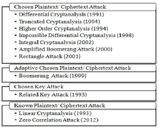

For example, when it comes to block ciphers, you’re facing cryptanalytic attacks like:
some cryptanalytic attacks on block ciphers (and year of publication)
Note that this isn’t even considering other important things like authentication (encrypt-then-MAC) and stuff yet.
