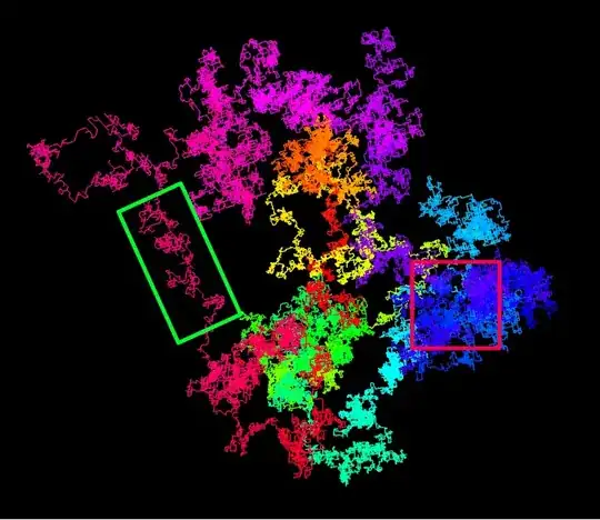

The best way to visualise randomness is with the following random walk over 22 trillion $ \pi $ digits. Consider what the bias and chi values might be for the contents of the two boxes. They'd be wildly different, but both are perfectly correct as $ \pi $ is perfectly random. Your 254.3 value simple means that, meh, it's exactly 50/50 that your particular sequence is random. One value like that has little statistical significance.
pi
Normal distributions or those based on a larger range are exactly the same method, with different numbers of degrees of freedom, but. Have a look here. But of course a TRNG doesn't output different distributions natively. All randomness extraction techniques output uniformly distributed bytes. And you can't have a normal distribution for discrete data like quantisized RNG bytes anyway. That would be a Binomial distribution with p $ \neq $ 0.5.

  • @valerio_new No absolutely not - you should never have a chi=0. That's not optimal. If chi=0, then you have an exactly uniform distribution of bytes in your sample. So there would be exactly $ \frac{1}{256} $ number of each value of byte. The chances of that happening with a large sample are zero. Most likely your generator is simply broken in that case. Read over the purpose of the chi test and how you applied it to random fluctuations of data results. And try to think of the shape my piccy would have to be so that chi=0 in both red and green squares. – Paul Uszak Mar 30 '18 at 02:42
    As to probability, you can't mathematically have p(isRandom)=100%. There is no statistical test in the world that can prove randomness. We can only disprove it. We can't prove that $ \pi $ digits are random, we just suspect it very very much. – Paul Uszak Mar 30 '18 at 02:57
    Calling something deterministic random is problematic. We do not currently know if pi is normal. Meaning the frequency of digitsand digit sequences is uniform. – Meir Maor Mar 30 '18 at 03:49
