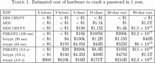

Also: you might want to consider scrypt instead of PBKDF2 (at least for the master key), for it provides better security for a given time overhead, as summarized in this table from the scrypt paper (2009):
Estimated cost of hardware to crack a password in one year
Update (2020): state of the art has evolved. Bitcoin mining has shown that dedicated ASICs performing SHA-256 at high rate (220 TH/s) and efficiency (15 pJ/H) can become commercially available for few thousand US dollars. This makes it untenable to rely on PBKDF2-HMAC run on standard hardware for stretching of user-chosen passwords in high-security applications. Scrypt still stands strong, however the new best practice for password hashing is the winner of the password hashing competition, Argon2.
