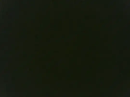

Yes absolutely. I believe that web cams make excellent true random number generators, but. The camera has to be operated within a visually managed environment. This is necessary to determine and control entropy of the resultant images for quality control purposes. The trick is not to rely on the scene the camera sees, but the image noise. Only God himself can predict this noise, hence true entropy. Consider this - all low light web cam images generated in the world are unique.
As mentioned, they can be slow. A webcam's no beam spitter. I estimate that you'll get 0.5Mb/s of true randomness from a VGA camera. That's still orders of magnitude faster than /dev/random. It's probably the simplest way to generate true entropy though. Your subsequent issue will be randomness extraction. This means converting the image noise to bytes ranging uniformly between 0 - and 255. There are those that will tell you to shove it up a cryptographic function, which will work but is boring. There are other ways. The following shows proper web cam entropy, with a blown up and equalised view too. You don't need to, indeed shouldn't, pull funny faces at the camera:-
frame
Equalised view
An entropy generator based on this exact web cam principle is now on line here. The three channel lines represent about ~11 bits of total entropy, based on a very very conservative measure.

    Can you give any reasoning for the 0.5Mb/s you mention? Wouldn't it depend on framerate and compression (if any)? – otus Aug 30 '15 at 12:31
  • @otus 20KB JPEG x 90% entropy content * 4 captures/s * 8 bits =ish 0.5Mb/s. These figures have been obtained experimentally. – Paul Uszak Sep 02 '15 at 23:54
