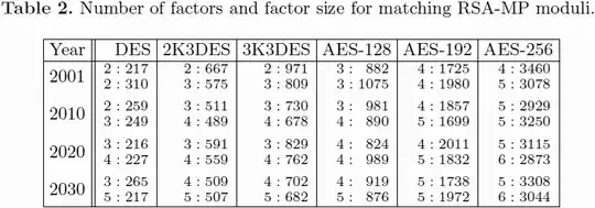

I know no standard about generation of RSA-MP key. However, for advice on the question of the bit size of $n$ and the number of factors $u$, one recommendable paper is Unbelievable Security: Matching AES security using public key systems, by Arjen K. Lenstra. See in particular the synthetic table giving $u:⌈\log_2\min(r_i)⌉$ for a given security level (in bits, with 2K3DES 95-bit), on a given year (with that parameter accounting for the author's evaluation of improvements on the algorithms, but not Moore's law), and according to two models.
table 2 from Unbelievable Security
Corrected: Following that size advice even at the 2K3DES level (for any entry starting Y2010), adding about $32/u$ bits per year to account for Moore's law (previously forgot that!), and choosing primes of one key randomly, my opinion is there's no need to worry about factorization attacks on that key till the Y2030 limit of that table. Notice that my endorsement assume that an adversary has no significant interest in factoring a single random key among extremely many.
