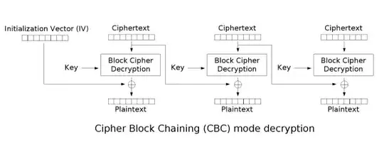

In CBC mode I know that if i get a corrupted Ci* block than Pi and Pi+1 will be wrong during the decryption, but i believe that this happens only when Ci* is not envolved during the feedback stage at the encryption, my question is what happens if the corrupted block is a feedback at the encryption stage, will it have the same impact as before?

  • What exactly do you mean by "the feedback stage"? AFAIK, there is no "feedback stage" in CBC mode that some blocks would not be involved in. Well, except for the trivial fact that the last block obviously has no following block to chain it with. – Ilmari Karonen Dec 01 '17 at 09:30
  • By feedback i mean that in order to encrypt Pi i have to use Ci-1. – Alonso Dec 01 '17 at 09:53
  • OK, so which blocks do you think that's not the case for? – Ilmari Karonen Dec 01 '17 at 10:24
  • In my opinion only C3 will decrypt uncorrectly because during the encryption all the later to C3 blocks will be encrypted using C3 so it dosent really matter if something happend to C3. During the decryption all the other blocks will give me the correct plain text – Alonso Dec 01 '17 at 11:21
  • It sounds like you've probably misunderstood something very fundamental about how CBC mode works. Are you studying crypto from a textbook, or just from random online sources? Have you read the Wikipedia description? Or this thread here on crypto.SE? – Ilmari Karonen Dec 01 '17 at 13:29
    i have read the wiki description, but i still don't understand, if i use a corrupted Ci* during the encryption i will get a Ci+1 instead of a Ci+1, but when i decrypt them shouldnt i get the same Pi+1? Or perhaps because of the miss calculation of Ci all the later blocks will be garbled during the decryption, because the IV lost it's meaning in the process? F.Y.I i appreciate the patience – Alonso Dec 01 '17 at 13:53
As you can see in the Wikipedia article a ciphertext block is used for two different things during decryption:
  1. as input to the block cipher to calculate the output, which is then XOR'ed with the previous ciphertext block to create the corresponding plaintext block at the same position;
  2. as input to the XOR to calculate the next plaintext block, together with the next decrypted block.
You can see it clearly in the picture, by following the arrows of one of the ciphertext blocks:
(XOR is denoted by $\oplus$ )
As the block cipher is a pseudo random permutation the plaintext block at the same position is indistinguishable from random even if only one bit is changed. The fact that it is XOR'ed with the value of the previous ciphertext block does not change this fact. There is only one restriction: the result is not identical to the plaintext block that would be calculated without the change.
Things are different with the next plaintext block. Only those bits that have flipped in the ciphertext block will be flipped in the next plaintext block. So the change is localized and not random.
Next or previous blocks are not affected as the affected ciphertext block, intermediate values or plaintext blocks are not used as input anywhere else.
