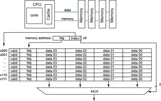

Everyone wants their computer to be "faster"; however, it doesn't really matter how much "faster" I make things in hardware, there will always be more software to put on it. The easiest way to make something faster is to bypass the bottleneck in the system, and this has been (and will most likely always be) memory that is not on-die (for a parity process). Back in the days for the 8086 and the 68000, the CPU and the memory bus ran at the same speed. Obviously, today this is not the case. Let's say that you have a CPU that can complete an instruction in 1ns (1GHz, and this is not true due to pipelines) and your external memory latency is 4ns (250Mhz, assuming no DDR tricks, so a 1:1 mapping). In this case, you need to wait 4 cycles unless you have some buffer memory in between: enter the cache.
The cache let's you skip the access if you already happen to have that data in the cache. There are many forms of cache from direct mapped (1-way) to fully associative caches. ( used to spend 2 weeks on this topic alone due to practical hardware issues, so this is the short-short version) In the simplest form, you have something that looks like this:
Cache example
The "tag" is the upper address, and the index in the row in the array. I use the last few bits for the output control. The "valid" column is a counter of some modulo. When I access the memory, I reset the counter. I did not include bits to do further control in the image. These bits can set all sort of other cache behaviors.
This is the origin of the cache timing attack. It takes me more time to go out to memory. The last time that data was constant time from memory was 30 years ago. The 80286 and 68010 both had caches, and "Big O" notation sort of went out the window with that in a practical sense.
If I want to speed up memory IO, I put a small subset of memory on die for fast, local memory; however, the issue is that I can fill it and then I run out of it. CPU's offer all sorts of cache locking, etc, but you need to have supervisor access. This means that I can put an array in cache and keep it there. When I crunch numbers, I generally cache lock the program. I then can just hammer data sets that are restricted to the speed of the bus without worrying out the IO cost of running the actual program.
The issue that this doesn't solve is the fact that interrupts can happen at any time, and even if you do not go out to memory for a cache miss, you still cannot guarantee that you will not have a hiccup in the throughput. This is why the AES-NI instructions have value; their timing is fixed cycle.
What can you actually do? Almost nothing; however, I've never seen anyone try filling the cache in userspace an then attacking it (keep in mind, I'm not a cryptographer, so I might have missed a reference). In the context of AES, you have the following code in C:

If you have debugging tools (JTAG to stop the clock and peek), you will see that s[6] is pulled from the cache and not memory because I filled memory by accessing the complete array before I did the lookup. Again, this does not solve the issue of an interrupt happening, even if the cache is still filled. If you have supervisor access on the CPU, you could just disable interrupts for the time of some critical section.
