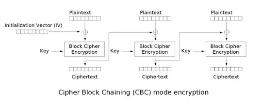

In practice we use something called a block mode.
The traditional block mode is cipher block chaining (see image). In this block mode we XOR the ciphertext of the a block with the plaintext of the next block. The first plaintext block will be XOR'd with a public initialization vector. This way we make sure that every ciphertext is different.
Cipher block chaining
How isn't this a weakness?
