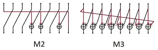

Concretely, given an element $x \in$ GF($2^8$), to multiply it by 2, we simply do a left shift and xor with 0b100011011 if the result of the shift gets above 0b11111111 (255). To multiply by 3, we multiply by 2 and add the input.
Those two multiplications can be described with 8x8 binary matrices. The easiest way to find the matrices is to think how those operations would be implemented in hardware. Well, there is an efficient way to do it. Given a 8 bit inputs, $y_0 y_1 y_2 y_3 y_4 y_5 y_6 y_7$, first store $y_0$, do a left shift, and xor the result with (0b00011011 $\cdot \ y_0$). And the multiplication by 3 is simply a multiplication by two xored with the input.
Those multiplications by 2 and 3 are described by the following binary matrices :
$M_{mul2}$:
\begin{bmatrix} 0 & 1 & 0 & 0 & 0 & 0 & 0 & 0\\ 0 & 0 & 1 & 0 & 0 & 0 & 0 & 0\\ 0 & 0 & 0 & 1 & 0 & 0 & 0 & 0\\ 1 & 0 & 0 & 0 & 1 & 0 & 0 & 0\\ 1 & 0 & 0 & 0 & 0 & 1 & 0 & 0\\ 0 & 0 & 0 & 0 & 0 & 0 & 1 & 0\\ 1 & 0 & 0 & 0 & 0 & 0 & 0 & 1\\ 1 & 0 & 0 & 0 & 0 & 0 & 0 & 0\\ \end{bmatrix}
$M_{mul3}$ (which is $M_{mul2} \oplus M_{identity}$):
\begin{bmatrix} 1 & 1 & 0 & 0 & 0 & 0 & 0 & 0\\ 0 & 1 & 1 & 0 & 0 & 0 & 0 & 0\\ 0 & 0 & 1 & 1 & 0 & 0 & 0 & 0\\ 1 & 0 & 0 & 1 & 1 & 0 & 0 & 0\\ 1 & 0 & 0 & 0 & 1 & 1 & 0 & 0\\ 0 & 0 & 0 & 0 & 0 & 1 & 1 & 0\\ 1 & 0 & 0 & 0 & 0 & 0 & 1 & 1\\ 1 & 0 & 0 & 0 & 0 & 0 & 0 & 1\\ \end{bmatrix}
Actually, from $M_{mul2}$ and $M_{identity}$ you can construct all the matrices of for the multiplication in the AES field by combining them with a double and add algorithm.
