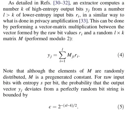

A: What if we choose $H$ to be a fixed function, yet instead of choosing a fixed matrix we choose a fixed ‘cryptographic hash function’ like SHAKE128? It is hard to say, because unlike universal hash families, cryptographic hash functions are designed not to have any interesting properties like linearity of matrix multiplication.
