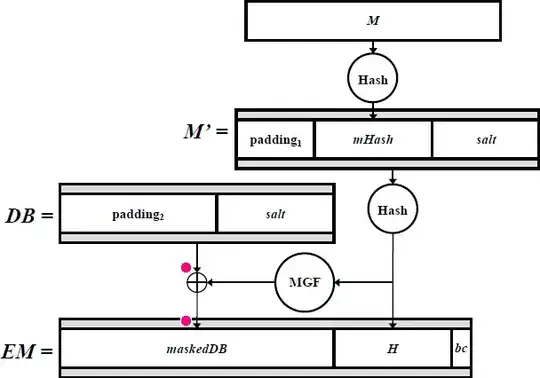

In normal RSASSA-PSS, the signing of $M$ use a random $\mathit{salt}$ to produce the padded message $\mathit{EM}$ as follows
EMSA-PSS
It is then applied to $\mathit{EM}$ the RSA private-key function $x\mapsto x^d\bmod N$, yielding the signature (for simplification I ignore conversions between octet strings and integers).
Verification procedure is
  1. Apply the RSA public key function $x\mapsto x^e\bmod N$ to the signature, yielding $\mathit{EM}$.
  2. Check a few bit(s) of $\mathit{EM}$ on the left (not in the drawing), and the bc octet on the right.
  3. Extract $H$ from $\mathit{EM}$.
  4. Apply MGF to $H$.
  5. By inverting the two arrows marked with a pink dot, compute $\mathit{DB}$.
  6. Check $\text{padding}_2$ is all-zero in $\mathit{DB}$
  7. Extract $\mathit{salt}$ from $\mathit{DB}$.
  8. Compute the hash of the alleged message $M$ (expected to match the true $M$), yielding alleged $\mathit{mHash}$.
  9. Form the alleged $M'$ from the alleged $\mathit{mHash}$ and extracted $\mathit{salt}$.
  10. Hash that alleged $M'$, yielding the alleged $H$.
  11. Check that the alleged $H$ is equal to the $H$ extracted from $\mathit{EM}$.
If $\mathit{EM}$ had been further hashed as proposed in the question, that verification procedure could not take place, because the verifier does not initially know $\mathit{salt}$, and can thus not compute $\mathit{EM}$ in the forward direction then hash it!
