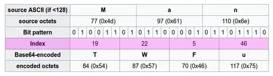

This is taken from the Wiki entry for Base64:
base64 example
If you really intended to tamper Base64 encoding to provide encryption, it could be done at the Index level highlighted above. You would need a secret key, a key derivation function tailored to create a high entropy seed which then started off a pseudo random number generator. The generator's (6 bit) output would then be XORed with the Index to change the encoding for every character. And this technique can be reversed to decipher the encrypted message.
You see that it's all a bit of a bother. Traditionally you'd create the cipher text and then encode it. Other than cropping a typical 8 bit random sequence to 6 bits, the workload is identical though to the traditional stream cipher. Actually you need 33% extra computations, but that's neither here nor there.
You might be the first to have thought of this Base64 variant as no one seems to be aware of similar behaviour. This should work though.

  • Thanks for this interesting suggestion! Actually, I had in mind simple stuff, like permuting the 6bit letter table association. Or introducing a key and have a bitwise xor operation on each letter cycling through the key, or similar. – Kagaratsch Jul 22 '17 at 16:20
    @Kagaratsch Well I think we're thinking on similar lines. To permute you'll need PRNG functionality and to link a key to a PRNG you'll need some sort of key derivation function otherwise there'll be a mismatch between the key format and the format /state required to operate the PRNG. If you simply permute without a key, or use the your key character cycling, the scheme's not very secure and this is crypto.SE after all :-) – Paul Uszak Jul 22 '17 at 16:46
    @PaulUszak That technical name is actually pretty obvious as soon as you know it… it's simply called "XOR cipher". ;) Yet, note that frequency analysis will trivially break it. Same goes for known plaintext attacks. Oh, and to be complete regarding the technical naming: when you throw in a prng, such a "XOR cipher" turns into a "stream cipher". But you probably knew that already, didn't you? – e-sushi Jul 23 '17 at 01:51
  • @e-sushi No, no, that's not what I meant. Cycling round through the key means that the plain text will be XORed with the same sequence over and over, and in the same order. I thought there was some more specific name for that effect? There's 100s of classic ciphers on Wikipedia, all with names. Poly-cyclonic-transpopulation? But then, perhaps not... – Paul Uszak Jul 23 '17 at 02:06
    @PaulUszak Not sure why you say "no". Also, you can be confident I know what "cycling" means. A XOR cipher does cycle through the same key over and over again and in the same order, just like you describe. Check the "example" of that wiki link; it matches your descriptions 100%… a bitwise xor operation on each letter cycling through the key and Cycling round through the key means that the plain text will be XORed with the same sequence over and over, and in the same order. — that's called "XOR cipher". No mistake or language gap there. – e-sushi Jul 23 '17 at 02:25
    Any way you tweak base64 like this can be factored into (a) defining a cipher on byte strings and then (b) applying standard base64 to its output, mapping ciphertext byte strings to plain text. There's no sense in merging (a) and (b)—it adds no security and needlessly complicates the description of both the underlying cipher and the implied standard base64. – Squeamish Ossifrage Jul 23 '17 at 16:43
