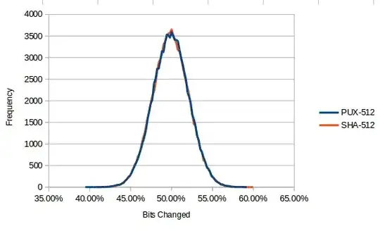

2) The goal of output bit non correlation is actually achieved. If it wasn't, many cryptographic random number generators (such as /dev/random and java.security.securerandom) would be biased and not feasible. This is down to a property called avalanche effect which can be measured. With some random inputs and fiddling about, you can arrive at a distribution such as:-
avalanche effect graph
where you can see that 50% of the output bits will change if you change any particular input bit.
