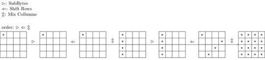

AES diffusion is taking cared of by 3 main functions:
  • SubBytes
  • Shift Rows
  • Mix Columns
SubBytes works as a 8-bit S-box. Thus if one bit change, the 8 bits of the byte are likely to change. With this step, each bit of a byte depend of each other.
This modification on the byte is then translated through the state via Shift Rows (still 1 byte affected) and then through the column (we moved from 1 byte affected to 4 bytes affected).
With one round, we therefore impacted on 4 bytes.
By doing it once again we will be affecting $4 \times 4$ bytes or the full state due to the nice coverage provided by Shift Rows and Mix columns.
Thus after 2 rounds, each bit has an influence on the full state.
This could be summarized by the following image where $\star$ represent a modification of a bit (and then byte). enter image description here
