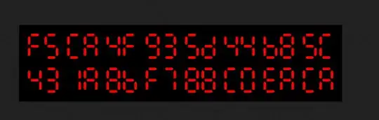

I've recently stumbled across this "moment" on Twitter, where there are three files, that show their own MD5 hashes.
As an example, this GIF (screen-shotted in the following image), has the hash:
f5ca4f935d44b85c431a8bf788c0eaca
Screenshot
They obviously match. Also this looks like the sort of attack that would normally take $2^{128}$ evaluations instead of the usual $2^{64}$ for a collision because you're going for a very specific message-hash pair.
So, how does this work, that a file can display its own MD5 hash?
