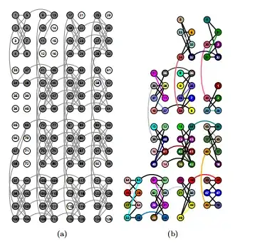

With the threat of alien extermination ringing in their ears, Bian and co have calculated R(3,3) and R(m,2) where m = 4, 5, 6, 7 and 8.
Their quantum computer uses qubits in the form of superconducting circuits in which 1s and 0s correspond to the currents travelling in opposite directions and the laws of quantum mechanics allow both states to exist simultaneously. So a single circuit can represent both a 0 and 1 at the same time.
What’s useful in this calculation is that whenever a solution occurs, it is the result of increasing the number of guests by one. So in R(3,3), parties with 1, 2, 3, 4, and 5 guests produce a null result. However, the dynamics of the problem change dramatically when their are 6 guests and this is straightforward to spot with the appropriate quantum algorithm.
Bian and co say the calculation for R(8,2) used 84 qubits, of which 28 were used in the computation and the rest for error correction. It took just 270 milliseconds. The result is 8 (as has been known for many years by conventional methods).
That’s an impressive result. Bian and co say “The R(8, 2) computation…to the best of our knowledge is the largest experimental implementation of a scientifically meaningful quantum algorithm.”
It’s also a vindication of kind for D-Wave Systems, the company that built this computer and markets a 128-qubit computer for $10 million.
