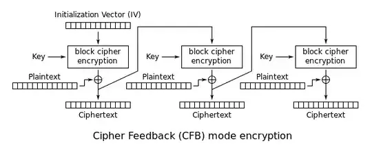

Yes, CFB just takes the previous block as the IV for the next block making it a stream cipher.
If you modify your iv_dec equal the result of the previous block, however long that is, it should work.
aes-cfb encrypt
Perhaps my answer was confusing because the image included above was for encryption and your asking about decryption.
aes-cfb decrypt
images from Wikipedia

CFB works as a stream cipher, where the random stream is generated encrypting the previous block of ciphertext. Then, the plaintext is just xored with this random generated stream.
CFB
To decrypt a particular byte, without decrypting all the others one can select the previous block (or the IV, if one is trying to decrypt a byte on the first block), encrypt it, select the corresponding byte and xoring it with the ciphertext.
In your example, you should encrypt the IV, select the second byte of the output and xor it with the second byte of the second block of the ciphertext (the first one being the IV).

  • What should I use to encrypt the IV? IV himself ? – ryuu Dec 19 '16 at 12:50
  • You encrypt the IV with the key. Give a look to the image. – ddddavidee Dec 19 '16 at 12:55
  • The API I am using must give an IV to encrypt something, key is required too of course. – ryuu Dec 19 '16 at 12:58
  • Because the API you're using is to encrypt/decrypt with the CFB mode. Here, in the image above, encryption is a single block, using ECB. – ddddavidee Dec 19 '16 at 13:00
  • I mean every single encryption is a ECB. The whole image is the CFB mode. – ddddavidee Dec 19 '16 at 13:01
