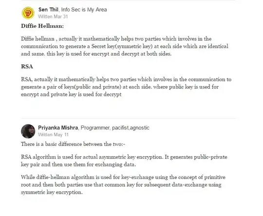

I've been reading the same thing on a lot of websites: RSA is for communication using the public and private key for both the server and client, whereas Diffie-Hellman is just for exchanging the same secret key that will then be used for both encryption and decryption. But they both depend on the same math.
E.g: This question on Quora:
Quora question
Then I was confused when I read that RSA shares a master and pre-master key, as well. As described in this answer.
