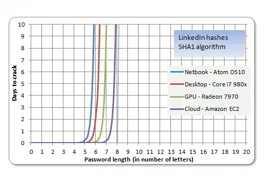

Here’s a graphic (from an SHA1 brute-force project) that puts things into perspective for you:
exponential growth showing days-needed-to-crack when brute-forcing linkedin SHA1 hashes
The fact that brute-force attacks cause you to quickly run out of several kinds of resources is the main reason why password-brute-forcing tools and utilities tend to prefer “dictionary attack” methods for longer passwords, and it’s one of the main reasons why cryptanalysts dive into cryptographic algorithms to find weaknesses and/or attack vectors that allow them to avoid having to bluntly brute-force things.
Long story short: Unless you’re a governmental agency with ample resources, or you’re merely attacking something small enough to fit your desktop computer, brute-force attacks can quickly become a rather futile effort.
