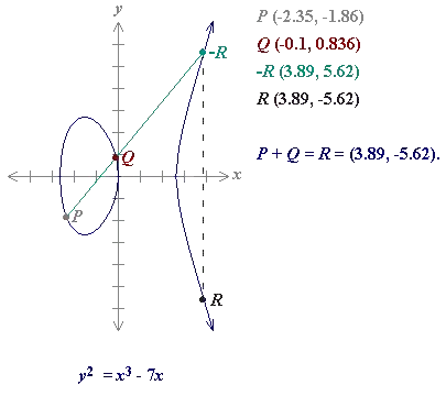

Graphically, addition looks like this for two distinct points ($P+Q=R$):

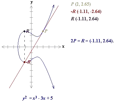

For doing $P+P=2P$, instead you draw a line tangent to $P$. Find where it intersects, and reflect about the $x$ axis. Like this:
Mathematically this is done by finding the line tangent to $P$, finding where it intersects and reflecting about $x$. The trick is to remember to do your math in the given field.
So, in your example the slope tangent at $P$ is $s=(3(16)^2+9)\cdot(2\cdot 5)^{-1}\bmod{23} = 11$. The $x$ coordinate for $2P$ is $s^2-2(16)\bmod{23}=20$.
The $y$ coordinate is $-5 + s \cdot (16-20)\bmod{23} = 20$.
A good applet to see what is going on can be found here. Once you have 2P, you add P to get 3P, and so on.
