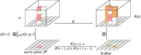

In the case of Keccak, $\theta$ is an operation mainly columns oriented. enter image description here
Which is why $\pi$ will ensure that every bits of a column is evenly spread in the slice. This prevent the creation of patterns.

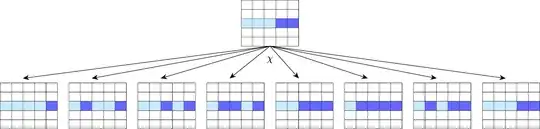

$\chi$ is the main ingredient in Keccak-$f$. It is the only part that is not linear. Without it Keccak would be super weak to cryptanalysis.
enter image description here propagation of a difference through $\chi$
