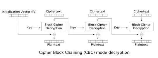

Actually, that's not true. Here's the CBC mode operation in the decryption direction:
CBC mode decryption
(Public domain image from Wikimedia Commons.)
If you examine the process closely, you will see that a specific plaintext block depends only on two ciphertext blocks (or a ciphertext block and the IV for the very first plaintext block).
So, if you modify a ciphertext block $N$ (say, flip one of the bits), then the resulting plaintext will have block $N$ garbled (because the modified block goes through the decryption, and unless we picked a ciphertext block which we already knew the decryption of, the result will be unpredictable). In addition, block $N+1$ will have the corresponding bits modified (in our example, the same bit will be flipped). And, there will be no other changes; all other plaintext blocks will be exactly what they were in the original message.
So, how can we use this observation? Well, if block $N$ is the one we want to affect, and we don't mind if block $N-1$ decrypts to something unpredictable, the obvious approach is to modify block $N-1$ of the ciphertext. If we guess that the real plaintext is $A$ (which corresponds to \$1), and we want it to read $B$ (which corresponds to (\$1000000), then we exclusive or $A \oplus B$ into ciphertext block $N-1$; this will cause the last ciphertext block to read exactly as we want it to.
