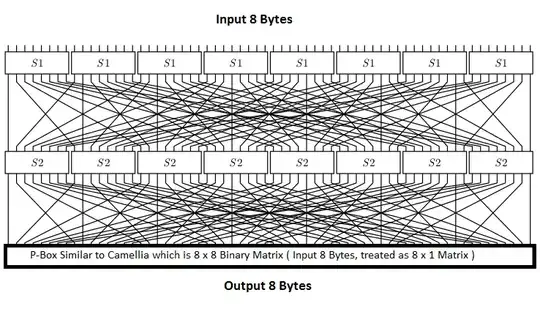

In a 128-bits Feistel Cipher:
I need suggestions about two variations of the Round Function
Variation-1
  1. $64$ bit input is divided into $8$ bytes
  2. Byte $0,1,2,3$ are substituted with Sbox1
  3. Byte $4,5,6,7$ are substituted with Sbox2.
  4. Then a $8 \times 8$ Binary Matrix is applied on the 8 bytes from 8 rows (Matrix similar to Camellia).
Variation-1
Variation-2
  1. 64 bit input of the round function is expressed as $8 \times 8$ binary matrix.
  2. Sbox1 is applied on the rows (on 8 bytes).
  3. Sbox2 is applied on the columns (on 8 bytes).
  4. 8 Bytes are made using bits of Rows.
  5. Then a $8 \times 8$ Binary Matrix is applied on the 8 bytes from 8 rows (Matrix similar to Camellia).
Variation - 2
Keeping in view that both S-boxes have non-linearity of 112 and maximum Differential Probability of $2^{-6}$ ($\approx$ the same level of security of AES).
Which variation is better in terms of security ? The same S-boxes are used in both the variations. Variation-2 is slow and more complex to implement, but thats not a issue

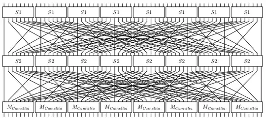

About the security of your first variation, it is sort of answered here.
This is your 1st variation. enter image description here
This is your 2nd variation (your $8 \times 8$ matrix idea is equivalent to apply a permutation). enter image description here
In your first variation, the application of the matrix is useless, one can consider the $S1$ (or $S2$) and the matrix as a single S-box. Hence you have no security gain.
In the second variation, you can see that even if you find the right differential on $S1$, it became harder to exploit because you apply a permutation before the following $S2$ (and subsequently the application of the matrix which is equivalent to another S-box).
Remark: Because in the second scheme you use a permutation, they cannot really be compared (apple vs oranges...)
With this in mind, I will let you decide which of these two variations is the most secure...

  • @Biv Thanks alot for making a clear diagram for the variation-2. But may i ask why you are applying Mcamellia 8 times to all 8 bytes separately treating 8 bits as input? (or i understood it wrong way, and Mcamellia is being applied to 8 bytes just like in camellia) From the Diagram you made, it make clear the Variation 2 will have better diffusion, changing one bit in input of sbox1, will cause change of atleast 4 different inputs to sbox2. which after passing from Mcamellia will propogate more change as compared to variation-1 – crypt May 12 '16 at 18:17
  • The P-function matrix is applied on an entire 64-bit value in camellia, it is not a binary matrix, but rather an 8x8 matrix with only values of 1 and 0, which is why op called it binary – Richie Frame May 12 '16 at 18:17
  • I didn't know that part about the Matrix, I thought it was applied on slot of 8 bits. Well then it is just a big permutation of bytes right @RichieFrame ? And therefore it does not add security if you were to compare the two scheme between each other. – Biv May 12 '16 at 18:24
  • @Biv i have updated the question using your images (a bit modified) – crypt May 12 '16 at 18:39
