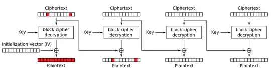

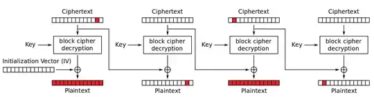

To move back to your question:
If $b_0$ and $b_1$ fall in the same block
CBC decryption failure 1 2 plaintext blocks will be corrupted, $n+2$ bits will be corrupted.
If $b_0$ and $b_1$ fall in two adjacent blocks
CBC decryption failure 2 3 plaintext blocks will be corrupted, $2n+1$ bits affected.
If $b_0$ and $b_1$ fall in two separate blocks
CBC decryption failure 3 4 plaintext blocks will be corrupted, $2n+2$ bits affected.
