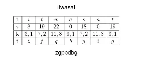

A polyalphabetic affine cipher can be seen as the composition of an affine cipher ($p \mapsto c \equiv a \times p + b \pmod{26})$ and a Vigenère cipher.
Consider we have a key such as $(a_{n\ mod\ 3},b_{n\ mod\ 3}) \in [(3,1); (7,2); (11,8)]$.
For instance itwas$_{plaintext}$ $\longrightarrow$ zgpbd$_{ciphertext}$. enter image description here

  • @otus I added picture, i think it is clear in picture. – Retikulum Apr 15 '16 at 14:11
  • Each pair of (a,b) results in a mapping from the alphabet in the normal order to the alphabet in another (permuted) order. So if your alphabet is of size m and you have n unknown pairs of (a,b), this means that you have a poly-alphabetical substitution matrix of m*n with permuted columns that you don't know. But this is a general challenge for analysis certainly much more difficult than the classical Vigenere. It's unlikely IMHO that someone would be able to provide you a recipe to straightforwardly solve the problem. – Mok-Kong Shen Apr 15 '16 at 14:55
  • @Retikulum, thanks, so it's a polyalphabetic affine cipher. – otus Apr 15 '16 at 14:58
