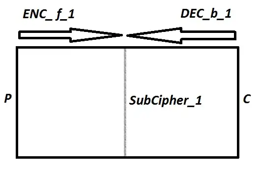

Cascading algorithms is a method of construction of bigger encryption algorithms. It is not a very good one, though. For instance, suppose that you cascade AES with another block cipher such as Serpent; or maybe you use two AES instances with two keys chosen independently. The hope may be to thereby produce a synthetic block cipher that will have twice the key length. But it does not deliver all these promises: the double-encryption method falls prey to the Meet-in-the-Middle attack (not to be confused with the unrelated Man-in-the-Middle attack). This schema may be enlightening:
Meet-in-the-Middle, from the Wikipedia page
So, by cascading two algorithms, you double the operational cost, but you do not get your money worth in security increase. To really get extra security, you must go to triple-encryption. This is why Triple-DES is triple-DES, not double-DES: the latter would not be substantially stronger than simple-DES.

  • You might want to make it clear that MITM doesn't apply to the OP's case, where you only have the ciphertext and are trying to brute-force the plaintext. It would only be usable indirectly, for key-recovery from a known-plaintext attack against another message. (Very much like the how the allies broke German codes in WWII: using known-plaintext attacks to recover the day's keys.) So this is obviously a critical property for a good cryptosystem, but unless I'm misunderstanding it completely, it doesn't help here. Thanks for bringing it up: interesting reading for casually-interested people :) – Peter Cordes Feb 29 '16 at 06:13
    Also, that diagram you extracted from the wiki article didn't make any sense until I went and read the article, where it explained what kind of attack it is, and that it trades space for time. Anyway, nice answer, but still room for improvement. :) – Peter Cordes Feb 29 '16 at 06:15
