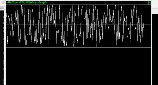

Edit 3
Upon further consideration of the simplest example of a 1 byte state, I realized that, for a 1 byte state, the function basically produces the same noise wave. A different input is to the function is equivalent to selecting a different starting point on the wave, and recursive calls just cycle forward through the wave one point at a time.
The initial state could be determined by recording 2 ** 8 outputs, or the entire cycle. Technically, for a one byte state, just knowing the one output allows you to know the previous one, and by extension all the ones before that.
However, I am not exactly sure how this train of thought extends to a multiple byte input state. I'm not sure if the same wave is generated with the difference being where on the wave it starts, or if different noise waves are generated by differing combinations of bytes. I conjecture the latter, as some combinations of input bytes do not have the same cycle length. I'm also not sure how to extend this idea beyond capturing all of the output bytes and finding which seed produced that particular order.
I graphed the noise wave for the one byte cycle, if anyone is curious to see it:
noise wave

    The reason you can't invert your permutation is because it is no permutation. The approach is similar to an unbalanced Feistel, but you made the mistake of including the half you want to modify in the F function you xor into it. – CodesInChaos Jan 25 '16 at 09:42
  • @CodesInChaos Thank you, that is a very useful observation and is very helpful regarding my question about the class of algorithm the function belongs to. I thought it was a permutation because the domain is equal to the codomain, but I guess I'm not sure what permutation meant (reading now!). And in retrospect that only applied when the input was a single byte anyways. So could I maybe fix that problem via generating a byte from the byte at counter, then xor that with the byte at counter + 1? Or do every two bytes as if they were the left/right halves in a normal Feistel? – Ella Rose Jan 25 '16 at 22:00
I don't think there is a way to check the period of such a sequence without actually computing it. That being said, having a long period like that is not desirable in cryptography.
A psuedorandom permutation is invertible. The fact the algorithm presented is not means that it is closer to being a psuedorandom function then a psuedorandom permutation.
However, I say "closer to", because a psuedorandom function will enter a cycle after significantly less then $2^N$ applications. The behavior of having such a long cycle length distinguishes the function from a random one.
The function presented produces biased output. Ideally, a proper hash function should evenly distribute it's output over the space of all possible bytes. Meaning, that if you take enough samples, for each index of output, you should see 256/256 different symbols appear at each index. Running my metrics against a sponge using the supplied function produces heavily biased outputs:
