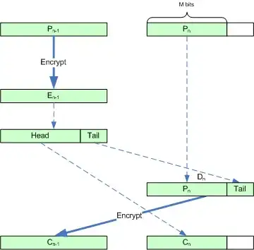

Ciphertext stealing (CS) is another alternative based on block-ciphers to produce ciphertext of the same size, but is easier to implement than FPE. Those are usually defined as extensions to non-streaming modes for block-ciphers. The Wikipedia page shows examples for ECB and CBC modes with ciphertext stealing. They can operate deterministically like FPE and the many-time pad attack as in CTR mode is not applicable. The only problem is that ciphertext stealing is only possible for plaintexts larger than a single block when the IV is static.
CS example for ECB:

Deterministic encryption as with FPE and (ECB/CBC)-CS enables you keep the same ciphertext size as plaintext size, where FPE additionally enables you to keep the same character set. Since those are not randomized, an attacker might be able to compare the ciphertexts of multiple plaintexts to determine whether the same plaintext was previously sent.
