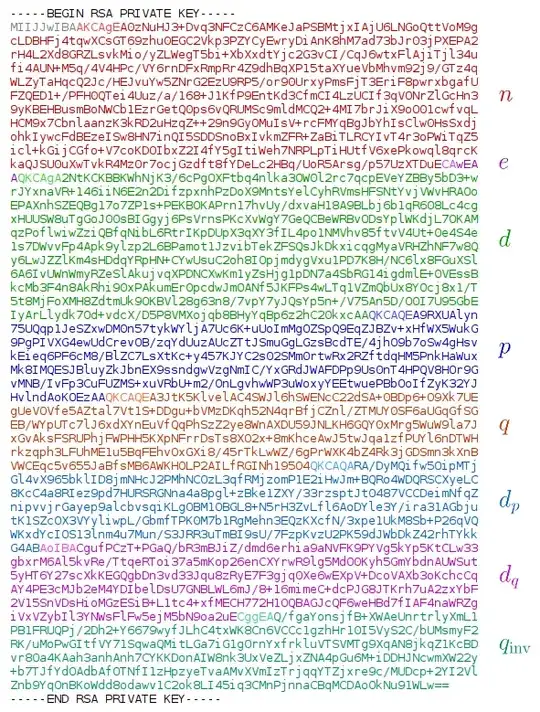

To visualize the arrangement of the individual components, I created the following graphic from a typical 4096-bit RSA private key file:
RSA private key with highlightning of the encoded numbers
The grey part right in the beginning is ASN.1 header data (encoding the fact that a sequence is about to follow, etc), followed by the integers forming the key as described above. The ASN.1 header data associated to each component (mostly a length field) is colored slightly brighter than the data representing the integer itself. Note that the pictured subdivision is not 100% accurate as one Base64 character encodes roughly $3/4$ raw bytes, hence some boundaries should actually run strictly within a single character.
