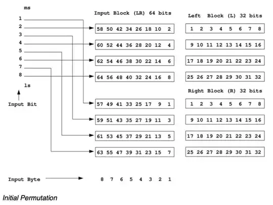

DES is hardware
There's a paper by Miles E. Smid and Dennis K. Branstad of the National Institute of Standards and Technology (NIST) entitled The Data Encryption Standard Past and Future, first appearing in Proceedings of the IEEE, vol. 76, no. 5, pp. 550-559, May 1988 (and not copyright eligible as a a U.S. government work), which makes the distinction between Basic standards, Interoperability standards, Interface standards and Implementation standards and points out that the DES is an interoperability standard. It describes how to interconnect an 8 bit interface to the Initial Permutation, Inverse Initial Permutation and Permuted Choice 1 as well describing which bits are association in time ordered hardware operations.
Note this is excerpted from an answer that shows Permuted Choice 1 is only 8 wires in hardware.
IP and IP-1 can be shown to be similarly as 8 wires:
Initial Permutation
  • So what you're saying is that the cross wiring is introduced because of I/O Constraints, or something like that may be? – Bilal Wasim Jan 03 '16 at 19:03
