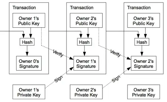

I'm trying to understand how a verification works in the image below:
digital signature
The goal is to simplify the signature generation and verification algorithm in a way that I can make it understandable for students that are not familiar with digital signatures or elliptic curve cryptography at all. So, what I am looking for is a pseudo/toy-algorithm (something like the Caesar cipher) that the students can use to understand how public and private keys work in an extremely simplified way.

    You do not have to understand a specific signature algorithm (e.g. ECDSA), but you must understand the abstract principles of asymmetric signatures. I think the picture is maximally abstracted. This means, by making it more simple it will be wrong or misleading. –  Oct 23 '15 at 05:19

The main difference between what you want an example for (digital signatures) and secure communication is this: the roles of the public and private keys are reversed.
Also, the content being encrypted is different. For secure communication, the entire message is encrypted. For digital signatures, the message format is irrelevant; you are trying to prove authenticity, not protect message content. Rather, it is a digest, hash, or checksum of the message that is encrypted.
The signature algorithm computes the digest, encrypts it with the private key (known only to the sender), and includes this encrypted digest (the signature) along with the message, to prove its authenticity.
The verification algorithm takes the public key (known to everyone) and uses it to decrypt the signature, as well as computing the hash or digest of the message itself. It then compares its computed hash of the message to the decrypted signature. If they are identical, verification was successful. If not, verification fails.
This is in contrast to security usage, protecting the content of a message. In this case, the message is encrypted using the public key of the recipient, and thus can only be decrypted by that intended recipient who has the matching private key.
So if you have an existing pen and paper example for security purposes, you could just use that same example, reversing the roles of the private and public keys. It's just a matter of understanding the differences in the process.
