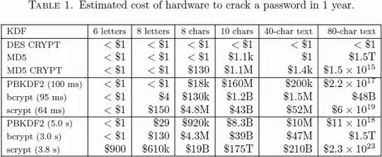

PBKDF2 is a giant progress compared to practices such as MD5(Password||Salt) → Key (where || stands for concatenation), but it is significantly inferior to what state-of-the-art allows. See the following table from the paper Stronger Key Derivation via Sequential Memory-Hard Functions defining the Scrypt Password-Based Key Derivation Function.
Estimated cost of hardware to crack a password in one year
In the following I discuss the PBKDF2 avenue envisioned by the OP; I might propose a simpler one, illustrating the concept of Sequential Memory-Hard Key Derivation Function, in a later post under preparation.
