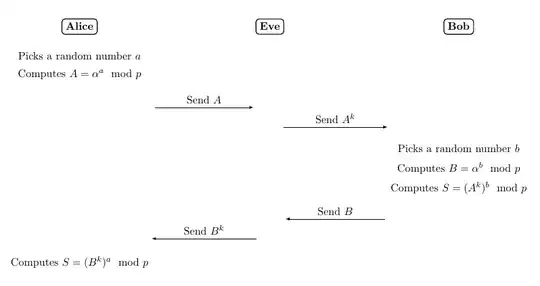

I am trying to understand the small subgroup confinement attack on the Diffie-Hellman algorithm. I will present the attack and try to explain why it works.
Small subgroup confinement attack on the Diffie-Hellman algorithm
Let $\mathbb{Z}_p^*$ be a group, where $p$ is a large prime and let $\alpha$ be a primitive root modulo $p$. Let's consider that Alice and Bob want to do a key agreement on the whole cyclic group $\mathbb{Z}^*_p$ using the Diffie-Hellman algorithm. The following sequence diagram illustrates how Eve can perform a small subgroup confinement attack:
Small subgroup attack on Diffie-Hellman key-exchange
By doing this, if $k$ is well-chosen, the secret $S$ can be found by exhaustive search.

Could someone approve or disapprove my demo?

    Here's a simpler way to see it: using the fact that $\alpha^k \in \mathbb{G}_w$ that you've already proved, you know that $A^k = (\alpha^k)^x \in \mathbb{G}_w$. Since the (new) $K$ is a power of $A^k$, it also lives in $\mathbb{G}_w$. – Chris Peikert Aug 19 '15 at 20:11
The proof provided in the question is correct, but as Chris Peikert pointed out in comments, there is an easier way to prove that $S \in \mathbb{G}_w$:
$ord(\alpha^k) = \frac{ord(\alpha)}{ord(\alpha) \wedge k} = \frac{p - 1}{(p-1) \wedge k} = \frac{p - 1}{k} = w$ so it implies that $\alpha^k \in \mathbb{G}_w$.
As $A^k = (\alpha^a)^k = (\alpha^k)^a$ is a power of $\alpha^k$, it also implies that $A^k \in \mathbb{G}_w$.
In the same way, $S$ is a power of $A^k$ so $S \in \mathbb{G}_w$.
