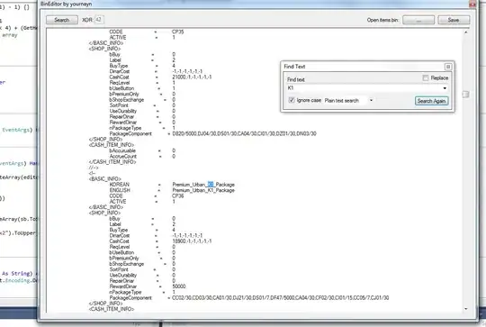

The file of interest is an encrypted/obfuscated .bin script, which cotains information on certain weaponstats eg. damage or accuracy. It is part of an older computergame. The raw file containts only hexvalues, which I "converted" to their Characters using extended ASCII. The output wasnt satisfying at all, untill I found out, that it was obfuscated using single byte XOR. Since there are only 256 different possible ways I went manually through all of them and had success with Key 42. This is what the decrypted script looks like:
I made my own small Tool, which decrypts the file hex -> ascii -> xor decrypt and saves the changes with hex <- ascii <- xor encrypt. So right now I am able to manipulate some weaponstats and save the file into its previous format.

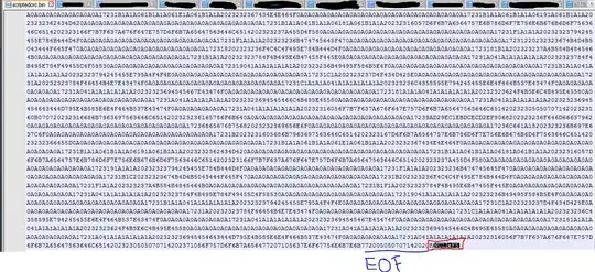

When I try to start the game with my manipulated file it appears a CRC checksum error and it wont start. I was aware about this and did some research already, the checksum used is definitely CRC32 and I found out, that you can force a files checksum to any value by appending 4 bytes, but it obviously wont work due to the file format:
The CRC32 checksum is now similar to the untouched file, but the game cant read it and doesnt start and this is where Im stuck.
