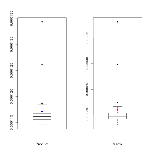

Even Rijndael usually is implemented storing the S-Boxes, the calculation times looks not very relevant, but perhaps they are, aren't it?
In those boxplots are represented average calculation for each of the candidate pairs. On the left using doing the modular product and on the right using the MDS matrix suggested in the Rijndael's documents.
Apart from the think that the matrix method is not better in general, the times for the official pair are represented by coloured dots. There are very many better candidates.

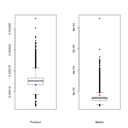

I did a seconds figure as a branch that assumes that the official $\mu(z)$ has something special I cannot see.
Here that data set are the 223 different $\nu(z)$ having $\mu(z)=z^4+z^3+z^2+z+1$. Again be careful with the scales on the y axis.
The calculation time for the official pairs have been also draw as coloured points. And here the official $\nu(z)$ doesn't show any timing property.
The code of this test is in a Rijndael project in github. From a command line it can be repeated by call $ python Polynomials.py --test-ring=8 and the basic things make with R are in a Polynomials subdirectory.
