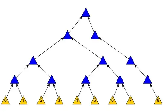

Example diagrams of the problem are shown below, showing insertions of leaf 0 at the start. Nodes requiring recalculations are in blue.
Original Fig.1 Original Tree.
Trivial insertion of data item 0
Fig. 2 Updated tree resulting from trivial insertion of leaf 0. Blue shaded nodes require re-hashing.

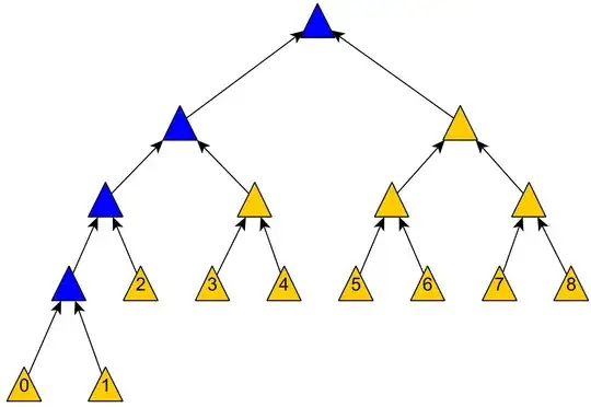

Ideal insertion of data item 0
Fig. 3 Updated tree resulting from ideal insertion of leaf 0. Blue shaded nodes require re-hashing.

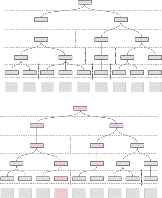

This is an answer that I haven't fully vetted but am providing because I haven't seen it elsewhere and believe it addresses many of the issues you've raised.
The basic idea is, at each level of the tree, treat the hashed value as data to be used to construct group node boundaries. For example, provide a rolling hash (e.g. adler32) to group nodes under the same parent before a boundary break. Rolling hashes are nice for computational efficiency so, if you don't care about that, just use any hash (sha256, etc.), feeding in node values and causing a boundary break when the lower bits meet some pattern criteria (say the lower two bits are 0, giving a break $\frac{1}{4}$ of the time).
As you scan a level of Merkle indexes, add parent nodes to the level above as needed, grouping one, two, three, etc. ($1$ to $K$ children, say) under a single parent. When only one parent remains, you've reached the top of the tree.
Since everything is local, alterations to a single node, whether it's a leaf node or an index node, be it edit, insert or delete, will most likely only have local consequences, which translates to $O(\lg n)$ operations. That is, whenever a node has been altered, scan left and scan right to find boundaries, marking nodes that need to be altered as necessary and traversing up the tree with the alterations as needed.
For a "vanilla" Merkle tree, the whole tree index might need to be recalculated after one alteration. Using a self balancing tree, like an AVL or red-black tree, might help, but would be dependent on the order of edit, insert or delete, which means you would need to carry the history of edits around with the structure rather than being able to construct the structure just from the data (the $n = 2^b$ nodes).
Tying the tree structure to the content means that it's order independent, allowing two different parties to come up with the same index tree based on the underlying data.
Here are some crude pictures to illustrate:
An edit to one of the underlying blocks that percolates up the hashed indicies of the tree:
An insert that causes a height change and some neighboring nodes to alter:
Red nodes are nodes directly affected by the alteration and purple nodes are ones affected by changing the boundary. Dashed and dotted vertical lines are the group boundary breaks based on hashing the nodes index values for a given (horizontal) level.
Again, I haven't fully vetted this idea so there might be some fundamental problems with this approach.
