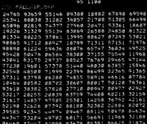

The reason you could not insert numbers into the online encrypt/decrypt tool you found is because that tool was only designed for the modulo 26 addition of letters.
Here is one example of what a CIA one-time-pad key looked like during the Cold War:
OTP numbers example

    Careful Patriot. You're creating the impression that OTPs might actually be useable in practice. That can't be right. Can it :-) – Paul Uszak Jul 17 '19 at 16:00
  • Seriously now - ref. TAPIR card. I thought that it was common to encode numerals in triplicate, not duplicate. Is that not common then? – Paul Uszak Jul 18 '19 at 00:44
    @Paul Uszak As you know, the TAPIR converts letters to numbers and provides structure to a message--this kind of fractionation was common amongst the East Germans (I do miss them) and Russians in the DDR/CCCP days. Then you pass a one-time pad of numerals over the fractionated plaintext. Not gonna break such traffic (without a compromise during key exchange/misuse/surreptitious entry/etc.). A mix of double and single letters was more common than triple-letter groups. – Patriot Jul 18 '19 at 06:36

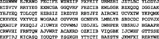

The one-time pad operates on bits and bytes and is agnostic to what symbols those bytes represent, so, yes, you should be able to use numbers as well.
When it comes to the Vernam cipher the answer is "you should, but for some reason you can't". That reason is most likely the fact that, although Morse code does encode digits, they don't appear to be used with the cipher, as this picture from Wikipedia shows
ciphertext
This next bit isn't the most rigorous answer you'll find but it might do: At some point in Neal Stephenson's Cryptonomicon, the author took the time to describe how the main character, who wants to telegraph 3 using a one-time pad, changed that digit to THREE. All five letters are then encrypted. It's reasonable to assume Stephenson has done his homework.
Yet the Baudot code used later with Telex machines also supports digits; so the answer to your question Is it possible to use numbers as a key is For some historical reason you can't, and the website reproduces that behaviour.
