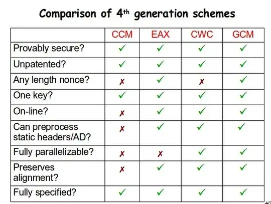

Personally, I would go for GCM (Galois Counter Mode) since it is efficient – meaning: it handles pretty much everything you’ld expect from it, while other modes sometimes tend to lack a specific feature here and there (see image below for a comparison that shows what I’m hinting at). Also, GCM has a pretty good performance (assuming non-flawed implementation). As you most probably already know, it provides Galois mode of authentication with the well-known CTR mode encryption. The CTR aspect practically means that it doesn’t need any padding (which avoids related attack potential) and it means that you keep a bit of flexibility when it comes to message/package lengths (something CCM for example doesn’t offer, since it uses a fixed block length). Also, the Galois field multiplication used for authentication can be computed in parallel, which enables higher speed/throughput than those authentication algorithms that use chaining modes (like CBC etc). Btw: in case you decide to check on GCM, you might find it handy to know that NIST Special Publication 800-38D includes recommendations for IV selection etc.

Comparing some of the options…
To compare, you might also want to check out the nice comparison table on slide 7 of this PPT file by David Wagner. I’ll quote it as a graphic here for reading convenience (as you’ll notice GCM is a winner):
comparison table

  • "... CCM. That mode is only defined for block ciphers with a block length of 128 bits" - I don't understand this as a critique of CCM, since this statement is true of GCM and OCB as well (EAX can be used with arbitrary block sizes). The major critiques of CCM are usually speed (2-pass) and that it's packet mode. – archie Aug 28 '14 at 19:56
  • "Also, GCM has a pretty good performance" - this should really be can have pretty good performance. As @SquareRootOfTwentyThree's answer notes, non hardware/SIMD-accelerated table based GCM (e.g. pure Java impls) is either memory intensive (typically 8k of key dependant tables for decent speed) or unbearably slow. On many platforms, GCM can be unusable, while CCM/EAX will still perform reasonably. – archie Aug 28 '14 at 20:07
    @archie What makes you think OCB is limited to 128 bits? Quoting Rogaway: You can use OCB with any block cipher that you like. … If you use OCB with a block cipher having a 64-bit block length instead… etc. and in case of doubt, I invite you to have a good look at the OCB-AES128, OCB-AES192, and OCB-AES256 test vectors. ;) – e-sushi Aug 28 '14 at 20:19
  • @e-sushi "And in case of doubt, have a look at the OCB-AES128, OCB-AES192, and OCB-AES256 test vectors" - last I looked those were all 128 bit block size ;). I was referencing RFC 7253 which explicitly limits the standardised OCB to 128 bits, but I take your point that OCB in general can use different block sizes. My question about the critique of CCM stands though... – archie Aug 28 '14 at 20:27
    @archie Well, one of the issues I see with CCM is that (to retain security) IV must be carefully chosen and never used more than once for a given key. That “choice” makes me feel a bit uncomfortable. Besides that, I’m probably not feeling love for CCM since it performs worse than OCB (and the fact that its development was merely sparked due to patent discussions when OCB mode was submitted). And let’s not forget EAX mode was proposed as a replacement for CCM (for good reasons). As comments are limited, check “the 2 attributes CCM lacks”. – e-sushi Aug 28 '14 at 20:47
  • GCM is a two pass scheme as well. Maybe it doesn't use a block cipher for the second pass, but that does not make it a single pass scheme in my mind (nor to the EAX authors, apparently "More recent still is GCM [22], a parallelizable, two-pass design based on multiplication in the finite field with 2128 elements.") – Maarten Bodewes Aug 28 '14 at 22:52
  • @owlstead Well, I would be willing to meet in the middle if we can agree on how Thomas Pornin describes it: the one-pass schemes are also often "one-and-a-half-pass". (At least, until my brain is able to round up again… 0100AM local time… brain=dead) – e-sushi Aug 28 '14 at 23:01
  • greed, 1 $1/2$ pass seems reasonable. I'm on CET as well, e-sushi. Germany and the Netherlands are quite close by :) Goodnight! – Maarten Bodewes Aug 28 '14 at 23:05
  • @owlstead (facepalm) Proves I’m desperately in need of a nap… – e-sushi Aug 28 '14 at 23:08
