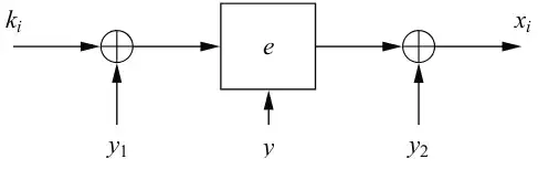

Key whitening is an extremely simple technique to make block ciphers like DES much more resistant against brute-force attacks. Like you’ve already discovered yourself, this is the basic scheme:
block cipher – basic scheme of key whitening
Or, defining it a bit more mathematically…
Encryption: $y = e_k,k_1 ,k_2 (x) = e_k (x \oplus k_1 ) \oplus k_2$
Decryption: $x = e_k^{-1},k_1 ,k_2 (x) = e_k^{-1} (y \oplus k_2 ) \oplus k_1$
In addition to the regular cipher key $k$, two whitening keys $k_1$ and $k_2$ are used to $\oplus$ (XOR-mask) the plaintext and ciphertext.

A prime example of such a cipher would be DES. A variant of DES which uses key whitening is DES-X. In the case of DES-X, the $k_2$ is derived from $k$ and $k_1$.
If you take a look around, you will notice that most modern block ciphers already apply key whitening internally by adding a sub-key prior to the first round and after the last round… prime example: AES.
