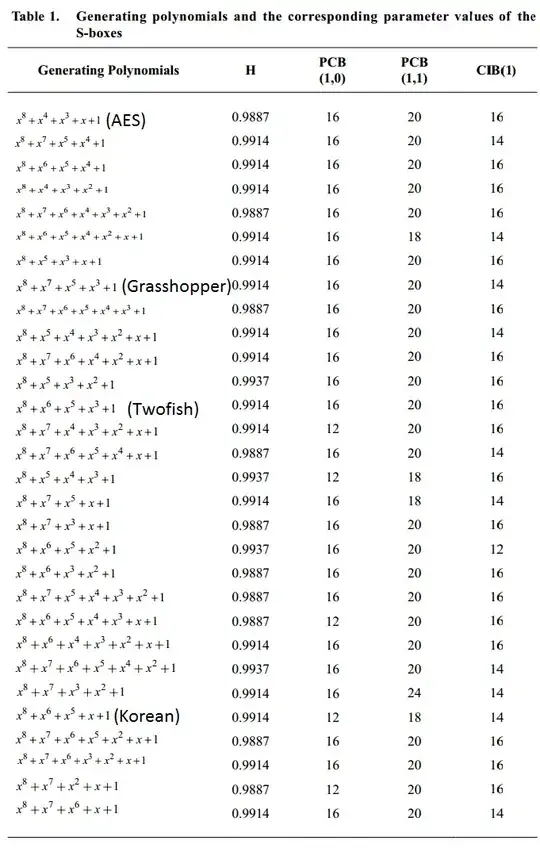

The image below shows the 30 irreducible polynomials for GF2^8. As an interesting factor it seems that 16 out of 30 has Hamming Weight of 4 (ignoring the MSB i.e x^8) and more interestingly 7 out of these 16 (with Hamming Weight 4) has nibble wise balanced Hamming Weight.
Twofish m(x) is on of the nibble wise balanced. One more beauty you will find in it is that if you Xor both the nibbles, you will get 1111. (i.e 0110 ^ 1001). The Camellia also uses same m(x).
Korean Cipher(i cant recall its exact name right now) seems to have better property in all these. For more details on these results refer to THIS Paper
I am just curious like you that does these relations of Hamming Weights have some impact? Because No designer has explained the details of selection of particular M(x) in their Cipher Design Specifications.

  • 'No designer has explained the details of selection of particular M(x)', at least for AES, see http://crypto.stackexchange.com/questions/251/design-properties-of-the-rijndael-finite-field/1345#1345 where I argue that it doesn't matter – poncho Oct 21 '16 at 16:50
