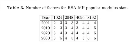

  • Table 3 of the paper Unbelievable Security: Matching AES security using public key systems also addresses this issue. It suggests that, for a 2048-bit modulus, $k=3$ primes offers no measurable loss of security. Starting in 2030, $k=4$ primes will offer no loss in security (it changes over time because NFS factoring speeds up faster than ECM factoring). Here is Table 3:
    table 3 from Lenstra's paper

    Independently: In Lenstra's table 3, 1024-bit column, the 5 and 4 on the right side (denoting use of a computationally equivalent model) are unreasonable. In 2013, GMP-ECM pulled a 274-bit factor from a 787-bit number product of two unknown primes. Pulling that from a 1024-bit number would not be too much harder, when 1024-bit GNFS factorization is way out of reach using comparable resources. [Note: it was found $16559819925107279963180573885975861071762981898238616724384425798932514688349020287$ from $(7^{337}+1)/8/101020140256422276570987002251440602782290400709$ ]. – fgrieu Apr 25 '14 at 22:46
