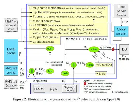

In May of 2019, they published a draft reference for randomness beacons, of which the version 2.0 service is an implementation of, as Internal Report 8213. This is an extremely detailed report of the design and implementation of the beacon system, and includes a security analysis with multiple threat assessments.
There are a few important changes with version 2.0 that are worth mentioning, the first is that they now have published block diagrams of how the system works, make note that although RNG3 is listed as quantum, the beacon project website specifies "We may soon integrate in the NIST Beacon a PML-developed quantum RNG (identified in the figure as #3) based on photon detection", implying that RNG3 is not currently active:
Beacon block diagram
The next important change is how the hash chains are built, and the addition of the skip list. I have not verified the complete operation of the skip list, but it would appear to use the 1st hour/day/month/year as the anchor point for a hash chain, so it is much faster to audit the current beacon to the start of the chain, which could be years long.
Now instead of going back half a million hashes to go back a year, you simply go back to the start of the hour, then back by hours to the start of the day, and so on until the chain is verified back to the first minute of the first hour of the first day of the year, with a maximum of 124 verifications to go back to the beginning of the current year.
So to verify pulse 502025 (Aug 16th 2019, 14:14 Z) against the start of the month pulse of 479573, you skip back 15 minutes to 502013, then in 14 skips of an hour (60 pulses) back to 501173, then in 15 skips of a day (1440 pulses) to 479573, for a total of 44 verifications, compared to 22453 without the skip list feature.
The final point of note is that this is not the only implementation of the version 2.0 beacon technology, there are services run by the University of Chile and government of Brazil. In addition to a hardware RNG, the Chilean beacon uses entropy sources gathered from seismic measurements in Chile, a stream from a local radio station, a selection of Twitter posts, and data from the Ethereum blockchain. Brazil actually runs multiple beacons, including their primary which uses a photonic quantum TRNG, as well as a combination beacon which also includes the outputs of the Chilean and NIST beacons as sources of entropy. The output of the Chilean beacon is also one of several inputs to Cloudflare's own beacon, which is not based on the NIST design or API.
At this point, the design seems sound, and if they fix the cert issues and get RNG3 active (maybe it already is), this and others like it do appear to have many uses, although cryptographic use may not be one of them, except as an additional source of entropy and not as a primary source.

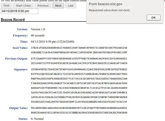

This is a screen shot as of 14/4/2018 00:19 UTC+0100. Sorry it's rather large, but that's necessary.
beacon
I don't know how long it's been frozen as I can't tell what timezone the server's on, but it's at least the 30 minutes I've been typing this. It's actually yesterday for me. That's >30 beacon bongs, pings or whatever they call it. Taken in combination with the certificate debacle, I would be very hesitant to build a legal time stamping service based around this. I wouldn't want my business credibility to be dependent on a duck's plaything.
I fully appreciate the work in progress status, but Google's Gmail was in beta for half a decade and pretty usable for most of that time. This service relies on continuity. Randomness and reliability cannot be separated here. This reliability issue is clearly in addition to those cryptographic ones in the other answers.
To further undermine credibility, it's down again as of this edit. This time the entire block chain has disappeared so nothing can be verified.
