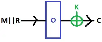

Assume:
  • $O$ be a reversible random permutation oracle on a finite set and $O^{-1}$ the inverse permutation (pretty much equivalent to a random permutation: What is the difference between a bijective random oracle and a random permutation?). Here, the attacker can call both $O$ and $O^{-1}$ on any input
  • $M$ be a fixed-length message to encrypt
  • $R$ some fixed-length random data. A new $R$ is generated every time you want to send a message
  • $K$ the secret key ($|K|=|M|+|R|$)
  • $C$ the encrypted message
  • $||$ the concatenation operator
Design:
draft
Encryption:
  • Generate $R$
  • Apply $O$ to $M||R$
  • Xor the result with $K$
  • Send the output $C=O(M||R)\oplus K$. $R$ is not sent.
Decryption:
  • Xor $C$ with $K$
  • Apply $O^{-1}$ on the result
  • Remove $R$ (easy since $R$ has a fixed length)
  • Enjoy $M=MSB_{|M|}[O^{-1}(K\oplus C)]$
As long as $R$ is long enough, is this design secure? Why?
I think that any attack that requires more than $2^{|R|}$ queries of the Oracle should be viewed as infeasible.

  • Do you have a precise definition for your "reversible random oracle"? – Ilmari Karonen Nov 20 '13 at 20:39
  • Do you want me to precise the "random oracle" part or the "reversible" part? (maybe both?) – udfrg2 Nov 20 '13 at 20:40
  • I know what both parts mean, but it's not obvious to me how you want to combine them. (For instance, in order to be reversible, the output obviously can't be entirely random.) – Ilmari Karonen Nov 20 '13 at 20:41
  • Well, let's say the random oracle is a random bijection of a finite set. If you have as much time as you want, you can map the inverse of this oracle. Let us assume here that we know the inverse. – udfrg2 Nov 20 '13 at 20:45
  • @udfrg2 Rigth now it's very hard to answer this. What is O? Over what domain is it defined? How is the randomness of the oracle generated and transmitted? How is R generated? Does an attacker know R? If not, how is it transmitted? How large are R, K, M? – orlp Nov 21 '13 at 03:22
    O is a random permutation oracle that is defined over a fixed-length set of binary strings. $:$ The randomness of the oracle is generated in an irrelevant manner, and it is only "transmitted" insofar as O itself is "transmitted" or transmitting something (namely ciphertexts) that depends on it counts as transmitting it. $;;;$ –  Nov 21 '13 at 06:39
    R is generated in the same way that randomized padding for PKE is generated, so the attacker does not know R. $:$ R is transmitted in the ciphertext, and is large enough that the number of oracle queries by the adversary must be much less than 2^(length(R)). $:$ M is one bit longer than the maximum possible plaintext length, and K is length(M)+length(R) bits long. $;;;$ –  Nov 21 '13 at 06:41
  • In a chosen plaintext attack, including M and R you can retrieve the key in one step. Besides, the scheme produces a ciphertext larger that the plaintext, as you're concatenating an R to each block. – daniel Nov 21 '13 at 10:52
  • @Ricky Demer Thanks for putting the right words. I've edited my question. – udfrg2 Nov 21 '13 at 11:38
  • @daniel I do agree that if the attacker makes you encrypt a single specific M||R, then he can get the key. However, R is not random any more if that case (that would mean the attacker is the random generator). – udfrg2 Nov 21 '13 at 11:47
    @udfrg2: I've proposed to move the sentence saying how many oracle queries are allowed to the end, because it is about the attackers resources and what you view as 'secure', rather than the generic scheme. An attack that requires slightly more than this in oracle requests might be notable as a security threat. – Cryptographeur Nov 21 '13 at 13:42
    @udfrg2: Have a look at this presentation about Even-Mansour. If we ignore the sentence saying the adversary can't ask $2^{|R|}$ queries of $O$, we can simplify the problem slightly by assuming $O=f$ is actually just a fixed random permutation. Then, can view your scheme as a variant of Even-Mansour, where the message $m=M||0$, $k_1=0||R$ and $k_2=K$. – Cryptographeur Nov 21 '13 at 13:44
  • @user8911 Interesting link. In my case, isn't a reversible random oracle on a finite set equivalent to a random permutation? Also, the part I don't like about the Even-Mansour scheme is that if you encrypt twice the same message, the output will be the same (and if in some protocol, you have to often send a specific message, the attacker will know you are sending this specific message. He can then possibly get additional information from this...). – udfrg2 Nov 21 '13 at 15:17
  • Oracle-Permutation: This partially comes down to trying to understand your question. My point was that in your case $k_1=0||R$, so encrypting twice with your scheme leads to two different invocations of E-M – Cryptographeur Nov 21 '13 at 15:54
  • @user8911 Well, according to my understanding, in a finite set, a random permutation is a random reversible oracle, so I'm fine with a random permutation. I also agree that with our modified Even-Mansour scheme, the same M leads to a different outputs each time. I was only speaking about the vanilla one. So this seems to basically boils down to decide whether $\oplus k1$ is equivalent to some randomness added to the input, isn't it? – udfrg2 Nov 21 '13 at 18:47

passive attacks
It appears at first glance that this construction is secure against a polynomial-time Eve, a passive eavesdropper, even under both a chosen-plaintext attack and chosen-ciphertext attack, in the sense that the attacker can't decode any other encrypted messages (other than the ones you allow him to decode during the chosen-ciphertext attack).
                    K
M||R----->[PRP]--->(+)---->C
active attacks
Because there is no message authentication code, an active attacker can conduct a replay attack.
If the "message" part is allowed to be short -- for example, 2 bytes long, an attacker who can trick the system into encoding all possible 2 byte messages, or decoding a few hundred thousand random values, can make a collection of ciphertexts that he knows corresponds to each possible 2 byte message. Because there is no message authentication code, an active attacker can inject any such such message of his choosing -- "Ya", "No", "Hm", etc.

The scheme is secure against chosen-plaintext attacks up to $2^{|R|/2}$ queries. Indeed, given this number of queries, it is likely that every encryption call yields a new value $R$, which has never used as part of the permutation input.
However, when this bound is reached, some problems occur. Suppose you encrypt the same message $M$ as many as $T=2^{|R|/2}$ times. Then it is likely that there is a collision in suffixes $R_1,\ldots, R_T$. Such a collision implies two identical permutation inputs and two identical ciphertexts, which is highly unlikely for $|M|>10$ and thus distinguishes the cipher from a random permutation.
