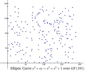

So it seems like this is the version of elliptic curves over a finite field:
Yes that looks pretty random. But I'm still not really seeing why they are the only equations that have cryptographic significance. It's difficult to imagine that if you simply took some other higher degree equation and applied modulus (to place within a group), then it seems like it would make sense that you'd get something that's also comparatively random.

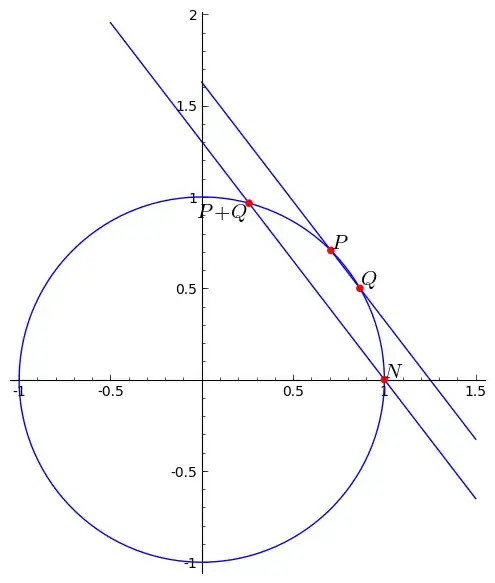

For example, conic sections (quadratic equations) do have a well-defined geometric addition law: given $P$ and $Q$, trace a line through them, and trace a parallel line that goes through the identity element. Here's a handy picture for one of the best known conics, the unit circle $x^2 + y^2 = 1$:
If you take the identity element to be $(1, 0)$, then you get the very simple addition formula (modulo your favorite prime)
$$ (x_3, y_3) = (x_1x_2 - y_1y_2, x_1y_2 + x_2y_1)$$
This is much faster than regular elliptic curve formulas, so why not use this? Well, the problem with conics is that the discrete logarithm in this group is no stronger than the discrete logarithm over the underlying field! So we would need very large keys, like prime-field discrete logarithms, without any advantage. That's not good.

  • The ECs that you see that look nice are over the reals. The elliptic curves over finite fields do not look that way at all. In fact they look pretty random which is another reason they are good for cryptography. AFAIK other functions over finite fields do not form a group. – mikeazo Nov 05 '13 at 03:03
  • OK so it makes more sense now, after seeing the before and after transformation of it going over the finite field (like caterpillar to butterfly). I added an EDIT as to what I'm still not really getting about why the ec's are so special in that way. It just seems like applying modulus (placing within a group) most equations with 2 higher degree variables would have a comparable effect to create something random enough for cryptographic purposes. – stackuser Nov 05 '13 at 03:46
