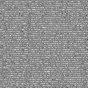

Assuming a random number generation process outputs lots of numbers between 0-9. First I gathered up a bunch of the numbers, converted them to binary and created a bitmap.
Not so random as you can see! That must be why you shouldn't just use raw integers as random numbers in a computer program. Look what happens when the numbers are converted to binary:

As you can see the first 4 bits are always 0011 which is not very random. Even looking at the 5th bit that is not very random either. From 0-7 it is always a 0 bit and only for 8 and 9 is it a 1 bit.
