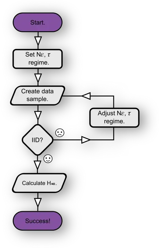

Then output bias is also irrelevant, as is colour or flicker. What matters is de-correlation of the raw output stream as that allows an accurate measurement of the entropy rate. If you can measure it, you can stick the right amount of it into libhydrogen.
In essence you keep slowing down the sample rate, or dropping significant bits of the sample values until the auto-correlation becomes negligible. Like this:-
chart
There's more detail here, including the means of IID determination and entropy measurement. It builds upon the work of Gaspard, Pierre; Wang, Xiao-Jing, Noise, chaos, and (ɛ, τ)-entropy per unit time, available here un-paywalled.
Once have $H_{\infty}$, simply inject enough of it into libhydrogen to satisfy your needs.
Speak up if you're going to create one time pads, as there is another little trick to minimise final bias.
