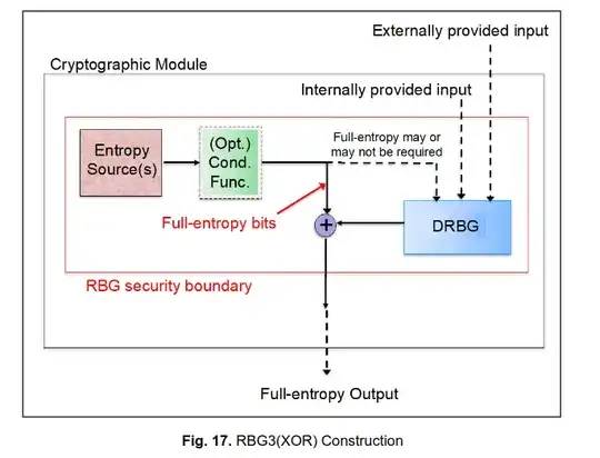

This is what we're all talking about:-
On the face of it, The (D)eterministic (R)andom (B)it (G)enerator is just there to mask a failure of the entropy source. If the pink blob is working, the DRBG (blue blob) is entirely irrelevant (unless manipulated by an adversary).
So yes, if pink (and green) is/are good, make your OTPs. But only if you ignore 800-90x and build a device yourself. See https://crypto.stackexchange.com/a/106942/23115 and https://uscode.house.gov/view.xhtml?req=granuleid:USC-prelim-title44-section3551&num=0&edition=prelim for the truth about US->global cryptography. I'm sorry that it's so boring, but cryptography is an art, yet control comes from political science.
